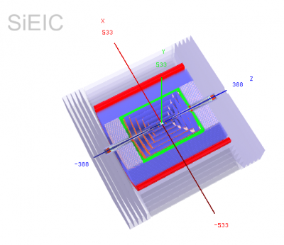

Visualizing the detector
You can visualize the SiEIC detector using Java (Jas4pp) or ROOT/C++. This assumes that you are using the bash shell on Linux/Mac with Java8 (Windows will be discussed later). Install Jas4pp program and run these commands to install the hepsim package:
wget http://atlaswww.hep.anl.gov/asc/jas4pp/download/current.php -O jas4pp.tgz
tar -zvxf jas4pp.tgz
cd jas4pp
source ./setup.sh # takes 5 sec for first-time optimization
Then copy the detector geometry file to the local directory where the file “jas4pp” is:
wget http://atlaswww.hep.anl.gov/hepsim/soft/detectors/sieic1/sieic1.heprep
Now we can visualize the detector as [File]-[Open data source]-[HepRep] XML and select file “sidloi3.heprep”. This is how to do this using the command line:
jas4pp sieic1.heprep
Now you should see the detector layout. Read more on Jas4pp here.
You can also visualize the detector using ROOT. Here are a few steps:
wget http://atlaswww.hep.anl.gov/hepsim/soft/detectors/sieic1/sieic1.gdml.gz
gunzip sieic1.gdml.gz
root # start root and type:
TGeoManager::Import("sieic1.gdml");
gGeoManager->GetTopVolume()->Draw("ogl");
You can get an image like this. You can explore different volumes by making them visible/invisible.

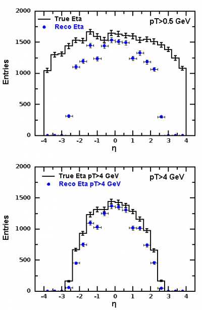

Here is an example of plotting the distribution of pseudorapidity for truth and reconstructed electrons: mc_electrons.py. After you have finished downloading the files, you will see the directory “pgun_elec_eta45_30gev%rfull051”. Run the example python code as:
hs-get pgun_elec_eta45_30gev%rfull051  # get all data
wget https://atlaswww.hep.anl.gov/asc/wikidoc/lib/exe/fetch.php?media=fcs:eic:mc_electrons.py -O mc_electrons.py
fpad mc_electrons.py                   # make a plot with Eta
This code creates this image of the SiEIC-v1 detector:
Note that the plot is done for all electrons starting from 1 GeV (a region where the efficiency is quite small).

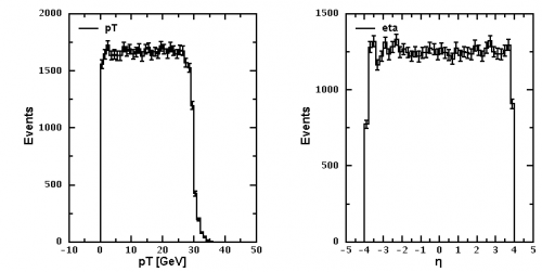

You can also look at single particles with flat pT, Eta and Phi. Here is an example this using a simple validation script mc_truth_flat.py for the MCparticle container inside LCIO file. We will use the “flat pT” sample called pgun_elec_eta4_pt30gev reconstructed with the tag “rfull052” (SiEIC with 1T solenoid):
hs-get pgun_elec_eta4_pt30gev%rfull052 data  2 100 # get 100 files in 2 threads in the directory "data"
fpad mc_truth_flat.py
The resulting image is:

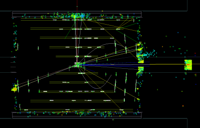

Displaying reconstructed events
If you already setup Jas4pp program, you can visualize the reconstructed events. we will read the simulated events: Open any *.slcio file you copied from HepSim using the menu [File]-[Open data source]-[LCIO] For e-p events, use this LCIO file from rfull051.
wget http://mc.hep.anl.gov/asc/hepsim/events/misc/pgun/pgun_eta45_p30_elec/rfull051/pgun_elec30gev_001_pandora.slcio
Then click a small button [Go] (top menu bar). It will process events. Then select again [File]-[New]-[Wired 4 view]. If you want to see how data records are organized inside the slcio file, do this [File]-[New]-[LCSim Event browser]

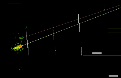

Event display
Here are images of ep collision with a scattered electron identified using the PFA. The images were done using DIS ep samples http://atlaswww.hep.anl.gov/hepsim/info.php?item=159. Reconstructed electron energy from PFA: E=16.92 GeV “EVGEN” energy: 16.90 GeV
