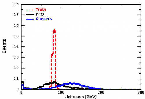

An example code which creates jet masses of anti-kT jets (R=0.8) is jetmass.py. It fills 3 histograms with jet masses for leading in pT antiKT jets for Z(10 TeV) to W+W- sample (truth, PFO, Clusters). Run it as:
fpad jetmass.py tev10mumu_pythia6_zprime10tev_ww%rfull009
The created image is shown below
