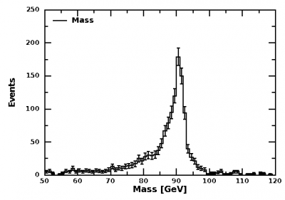

Z-peak using PFA
Let's calculate Z peak from particle-flow objects after full reconstruction using Pandora. You do not run “hs-get” command if you have done this before.
hs-get gev250ee_pythia6_zpole_ee%rfull001 gev250ee_pythia6_zpole_ee 2 4 # download 4 files
fpad mc_pflow.py
Z-peak from PFA

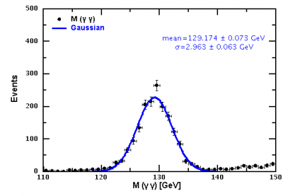

Higgs from γ γ
Let's calculate the Higgs peak from reconstructed photons after the PFA algorithm. This time you will need H→ gamma+gamma sample gev250ee_pythia6_higgs_gamgam: We set pT(γ)>10 GeV.
hs-get gev250ee_pythia6_higgs_gamgam%rfull001 gev250ee_pythia6_higgs_gamgam 2 10 # get 10 files in 2 threads
fpad mc_gammagamma.py

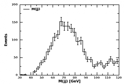

Z-peak using b-jets
Let's calculate Z peak from reconstructed b-jets. Jets are reconstructed using the Durham kT algorithm with ycut=0.05. This time we will download Z→ bbar sample. Look at gev250ee_pythia6_zpole_bbar. We assume pT(jet)>20 GeV.
hs-get gev250ee_pythia6_zpole_bbar%rfull001 gev250ee_pythia6_zpole_bbar  2 4 # download 4 files
fpad mc_jets.py
Z-peak from 2 jets
No any optimization for jet reconstruction was used. Consider other approaches to make more realistic dijet mass.

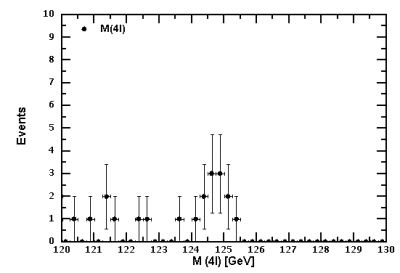

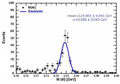

Higgs from 4 leptons
Let's calculate Higgs peak from reconstructed leptons in the channel H(125)→ ZZ* → 4L (electrons and muons). We will use particle flow objects to reconstruct and identify electrons and muons. This time we will download Higgs→ 4 lepton sample. Look at gev250ee_pythia6_higgs_zz_4l.
hs-get gev250ee_pythia6_higgs_zz_4l%rfull001 gev250ee_pythia6_higgs_zz_4l 2 100 # download 100 files in 2 threads
fpad mc_higgs_zz.py
Higgs from 4L

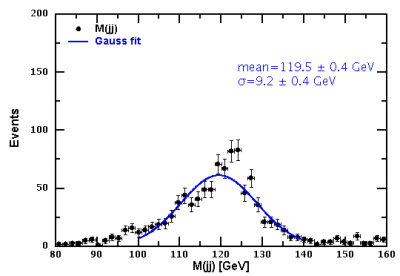

Higgs from bbar
This example uses the Jade algorithm to force 2 jets, and uses H→ bbar sample:
hs-get gev250ee_pythia6_higgs_bbar%rfull001 gev250ee_pythia6_higgs_bbar  2  15
fpad mc_higgs_bbar.py

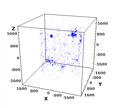

Showing calorimeter hits in 3D
One can also visualize calorimeter objects, such as hits. For example, here are calorimeter hits for Z→ bbar event (only one event is shown)
fpad mc_hits3D.py # hits in 3D for 1 events
fpad mc_hits.py   # phi distribution of hits
Location of calorimeter hits for 1 event:

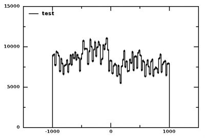

Phi angle of calorimeter hits for all events:

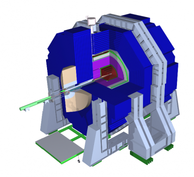

Detector geometry
The Monte Carlo files located in rfull001 link are done using the sidloi3 detector: http://lcsim.org/detectors/sidloi3.html. The XML geometry is given in http://lcsim.org/detectors/sidloi3.zip.
The SiD detector is shown here
