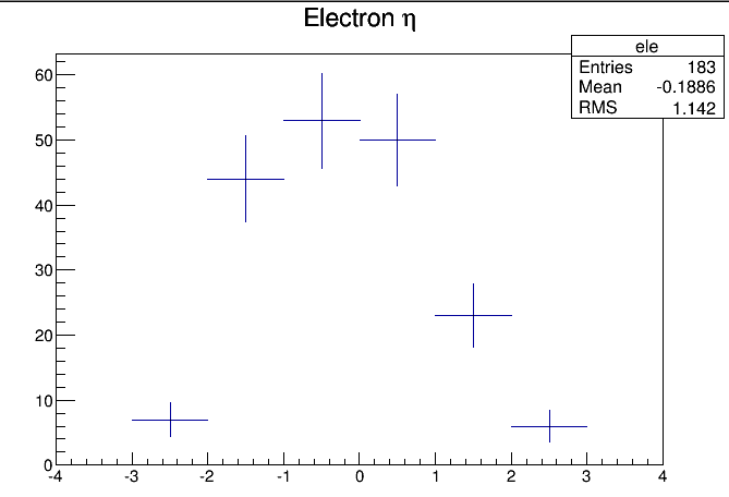

Run this code as:
python test.py file.root
You will see this image:
