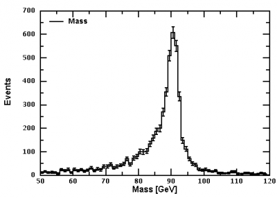

Z-peak using PFA
Let's calculate Z peak from particle-flow objects after full reconstruction using Pandora. You do not run “hs-get” command if you have done this before.
cd examples/slic/
hs-get gev250ee_pythia6_zpole_ee%rfull002 gev250ee_pythia6_zpole_ee # download all files
fpad mc_pflow.py
Z-peak from PFA

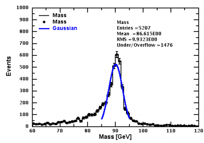

you can also do do some simple fit:
fpad mc_pflow_fit.py

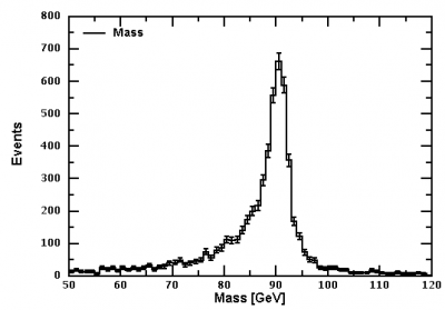

Z-peak using tracks
Let's calculate Z peak from reconstructed tracks (no Pandora and no particle identification) You do not run “hs-get” command if you have done this before.
fpad mc_tracks.py
Please correct on line 47 the variable Bfield=5 to Bfield=4 Tesla!
Z-peak from tracks

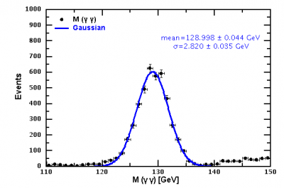

Higgs from γ γ
Let's calculate the Higgs peak from reconstructed photons after the PFA algorithm. This time you will need H→ gamma+gamma sample gev250ee_pythia6_higgs_gamgam: We set pT(γ)>10 GeV.
hs-get gev250ee_pythia6_higgs_gamgam%rfull002 gev250ee_pythia6_higgs_gamgam
fpad mc_gammagamma.py
Higgs from gamma+gamma

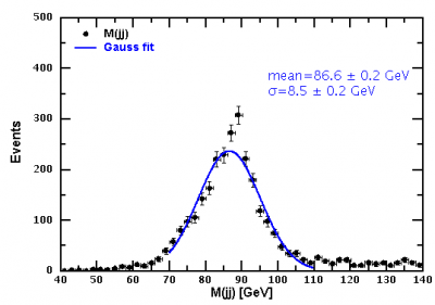

Z-peak using b-jets
Let's calculate Z peak from reconstructed b-jets. Jets are reconstructed using the Durham kT algorithm with ycut=0.05. This time we will download Z→ bbar sample. Look at gev250ee_pythia6_zpole_bbar. We assume pT(jet)>20 GeV.
hs-get gev250ee_pythia6_zpole_bbar%rfull002 gev250ee_pythia6_zpole_bbar
fpad mc_jets.py
Z-peak from 2 jets
No any optimization for jet reconstruction was used. Consider other approaches to make more realistic dijet mass.

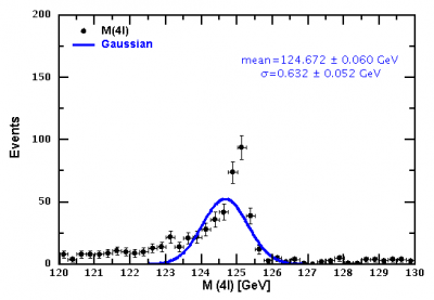

Higgs from 4 leptons
Let's calculate Higgs peak from reconstructed leptons in the channel H(125)→ ZZ* → 4L (electrons and muons). We will use particle flow objects to reconstruct and identify electrons and muons. This time we will download Higgs→ 4 lepton sample. Look at gev250ee_pythia6_higgs_zz_4l.
hs-get gev250ee_pythia6_higgs_zz_4l%rfull002 gev250ee_pythia6_higgs_zz_4l  # download 100 files in 2 threads
fpad mc_higgs_zz.py
Higgs from 4L

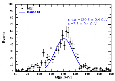

Higgs from bbar
This example uses the Jade algorithm to force 2 jets, and uses H→ bbar sample:
hs-get gev250ee_pythia6_higgs_bbar%rfull002 gev250ee_pythia6_higgs_bbar
fpad mc_higgs_bbar.py
